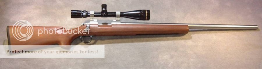

This is a sample photo of the kind of 40x style stock that I bought for $60 shipped on GunBroker some years ago. But it is really beat to heck with a chopped butt stock. I like the heft and wide flat bottom of this stock for stability, and I plan to use autobody glass and paint to transform it back into a thing of beauty for my .284 project. I've placed this SA 40X stock right next to a LA 700 HS stock to see how the cut-outs line up, and I can't see why it shouldn't work if I gut out the stock. This 40X SA stock is still 1" longer in overall length then the HS Long Action stock too....so no loss of forearm grip area.
