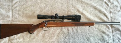

Okay, this is a Walther .22lr barrel for a Ruger 10/22....has a 22lr bore. Threaded and chambered for .22Mag with my 22M tight reamer, then fitted to a fairly early 77/22M which he also threaded. Another guy did the trigger, it's 12oz...that helps. 22Mag.jpeg22Mag groups.jpegThis was back in '96. Here's the gun and here's how it shoots, many people would probably be happy if their .22lrs shot like that. Target was shot either off the hood or tailgate of the truck, I don't remember. It's been very effective on literally thousands of groundsqirrels-prairie dogs-rockchucks-etc with Win. 40 JHP. During the season I don't leave home without it. I wouldn't hesitate to have one of these barrels on a .22. But I would want to know who did the work and what kind of chamber was used.
