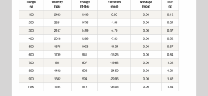

Here’s calcs for a 140SMK at 2650, should be very conservative speed wise. How did your actual come ups compare.

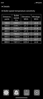

I went to federals website and punched their info into strelok pro and got this chart. The numbers look different than what you were getting from your calculator.
