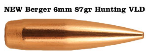

Ohhhhh, you're covered.
http://bulletin.accurateshooter.com/2010/11/berger-introduces-new-87gr-6mm-vld-for-110-twist-barrels/
