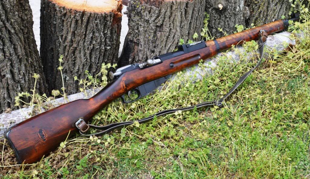

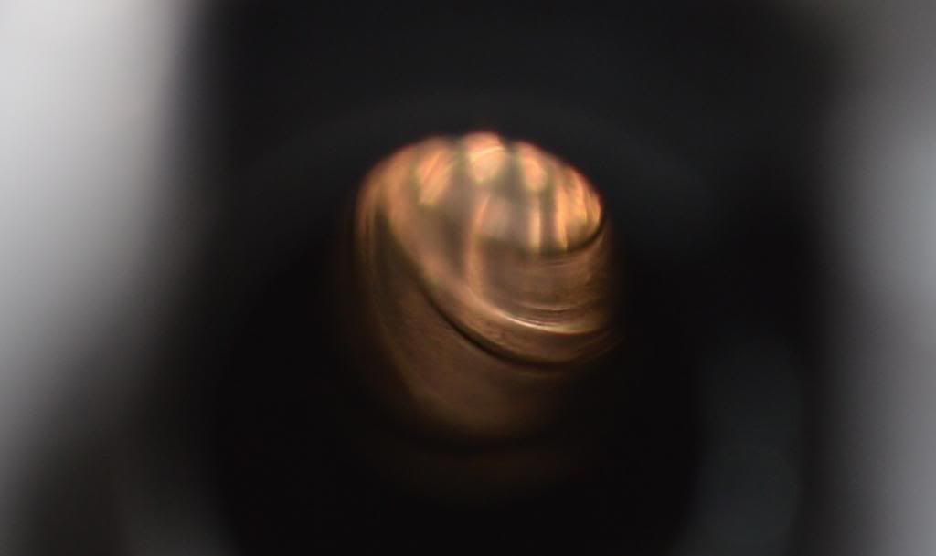

True. It is a 1932 dated barrel and the rifle is in near new condition including the bore. The bore showed signs of no use because tooling marks were visible. I scrounged up my last cent to purchase it mostly for that reason. The chamber cast came out clean and shows no throat erosion. Not counter bored either. By no means are you raining on my parade. I have had bores in far worse condition so I know where you going with the pitting. No I have not bore-scoped it as of yet but that is a step in the works. To date the round count is under 600 using medium charges.
This is the chamber end showing the beginning of the leades.
After seeing what great shape your SAKO M/28-30 is in the only mistake you made was not burning Vihtavuori powder and keeping it totally Finnish. ;D
And 99% of the people reading this posting here do not truly understand what a fantastic rifle you have pictured. ;)
