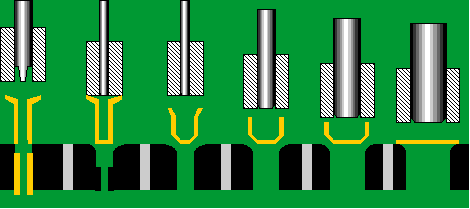

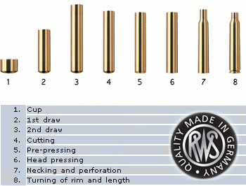

Brass is drawn from a cup shape to form the case. It is near impossible to have a uniform thickness of the walls. A taper from top to bottom is normal for the process.
http://bulletin.accurateshooter.com/tag/case/
