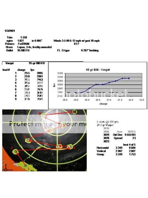

VARGET
29.5 to 31.9 gr. 31.9 gr yielded a stiff bolt. 5 shots at 31.2 gr yielded 3020 fps with a Vertical of 2.007". Horizontal was 3.249,wind was a killer). This was probably not on a node. After I looked at the ladder when I got home, 30.1 gr is probably closer to a node.

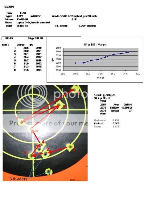

RE-15
29.5 to 31.6 gr. 32.0 gr yielded a stiff bolt with extractor marks on the brass. 5 shots at 30.1 gr yielded 2978 fps with a vertical of 0.603",wow) and a horizontal of 0.954". I got these off really fast and had pretty constant conditions. I am pleased with this and will go back and look at seating depth.

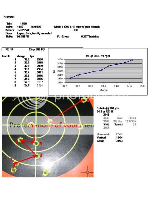

RE-17
32.2 to 34.6 gr. 34.6 gr was 100% load density, but no pressure signs observed. 5 shots at 34.6 grs yielded 3154 fps with a terrible 1.904" of vertical and 3.003" of horizontal. Definitely not on a node. A closer look at the data suggest 34.0 gr would have been much better on the vertical. Maybe a compressed load at 35.0-35.3 would have been ok. Didn't try it. I will try 34.0 gr again for group.

Thanks for the report with detailed information. My thinking is that the case capacity is too small for RL17 and you aren't getting into the best pressure range for that powder. Still the velocities are VERY impressive, and RL17, with some tuning,and maybe a different bullet) could be an interesting alternative for varminters looking for a very high velocity load out of a 6BR.
Alternatively, look at your Shots 6,7,8 RL17 load--they show almost no vertical and the 3050 range is a known node in the Dasher cases. I would try shooting groups in the 33.7 load range. NOTE that between 6,7,and 8 you have an even 20 fps vel difference between load increments. That could be a sign of a good pressure range.

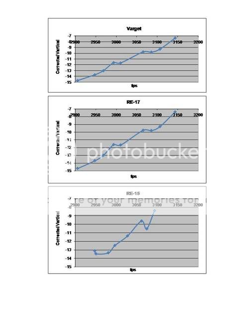

Ok. I have tried to play with this data set a little more. Dangerous for simple minds. I originally plotted the velocity versus charge to look for patterns in velocity and stable regions and then looked for regions of minimum vertical on the target. I decided to calculate the bullet drop using the initial muzzle velocity and Randy's listed B.C.,0.45) with the PCB ballistics software. I took this drop due to gravity,all as negative values) and added it to the vertical deviation from the point of aim for each target. I know I have read something like this below. I was trying to calculated a corrected vertical deviation. In my simple mind this should yield something similar to the barrel vibration,sine type wave) as the end of the barrel whips up and down at different powder charges. The attachment shows my results with all three powders when plotting this corrected vertical versus the muzzle velocity.
What the heck am I seeing? Never tried this before. Certainly not a sine wave. I am wondering if this is the multiple modes of vibration. Something happens at 3050-3060 fps with every powder. Is this a node? Or is this data trash since each point only represent a single shot and it has no statistically value. However, I see a pattern.... but I don't know what to make of it.
Any of you barrel harmonic pros want to straighten me out here.... I'm a little lost.
