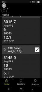

Fellas....switched out to a new 8lb lot of Varget as I finished the last....started out .4 under my previous load of 29.6 gr.
I am at a whopping 130 fps differance...same bullet (75 vld) same seating depth. same neck interference, same primer, everything the same but different lot # in powder.
Anyone ever seen a huge swing in difference like this...have shot a whole bunch of Varget in many calibers and have never seen such an extreme swing.
Bottom is my usual load...top was the 6 test rounds I made with new lot.

I've experienced lot variation with Varget but never this extreme....holy cow I'm not sure I can hit my upper node with this lot which is pretty frustrating.
Definitely needs more testing.
I've had many Varget swings over the years. I had a huge one like you mentioned with IMR 4064. But yes... Varget is all over the place when it comes to lot changes. Not surprised at all.
Ok thanks....this my first to see this huge of a swing but now I will join the club of "this sucks".
Prob safe to say I'll see this drop across other calibers...damm.
I changed to a new lot of LT-32 and it goes 100fps faster than the old lot. The thing is, the accurate powder nodes were the same as before, just faster.
