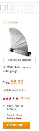

My numbers on those two gauges were correct but my thinking of my neck wall thickness was of by a decimal place, Im still getting used to reading a vernier scale. What I need is feeler gauges in the .0100-.0150 or .0200, which should be pretty easy to find.
Don't waste your time trying to find individual feelers, buy a set from an auto parts store.
If you are worried that the auto parts store will not sell machinist quality stuff, keep your eyes open for a SnapOn (or Mac) tool truck when you are driving around. You can ask your garage what day the SnapOn dealer comes, they usually arrive about the same time every week and you can just hang out and wait.
My SnapOn gauge set has .001, .0015, .002, etc gauges up to something pretty big. I also have a set in metric that probably splits some of the differences. With a metric and imperial set, you should be able to set up well enough.

Stack the blades together to get the thickness desired.
Read my previous post, that's how it's done.
There are many to choose from here.
http://www.amazon.com/s/ref=nb_sb_noss_1?url=search-alias%3Daps&field-keywords=feeler+gauge
Erik Cortina
Stack the blades together to get the thickness desired. I use one I bought at an auto parts store.
+1 - I bought one at Auto Zone for less than $8 including tax. It didn't have a .014 so I did what Erik says.
