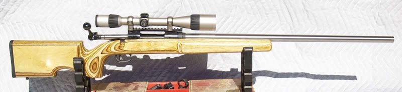

It's still a good base, there are some very fine triggers available for an add on, barrels can be changed out even by the ham fisted like me. Mine is in .243 also but started out with an accutrigger (which it still has. I've added a Sharpshooter Supply LVT stock and just installed a Lothar Walther 28", 8 twist barrel on it.
