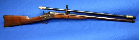

I'm putting 3 old single shots back to work with newly lined barrels. Last weekend I drilled 82" of barrel steel to prepare for the liners, then crowned them all Monday afternoon.
First and second pictures, top to bottom:
Marlin Ballard, 1889(?), Winchester LowWall, 1889, Remington #3, commonly known as the Hepburn, 1884(?)
The Ballard and Winchester looked like sewer pipes, the Hepburn wasn't correct to it's markings.
The Ballard was originally 32 Long, either CF or RF, with a reversible firing pin. It will be 32 S&W Long, a low pressure round suitable for it's cast frame.
The LowWall was 32 RF. I converted the breechblock to CF. It will be a 32-20WCF.
The Hepburn was originally 32-40Win, but had been rebored, rerifled, and rechambered sometime in the past to 33-40. No dies available based on the chamber cast and the odd bullet size(.338) made it a candidate for a liner so things match. It will be
32-40Win once again.
3rd picture, L-R, Hepburn, LowWall, Ballard

I will definitely update as things progress. All 3 will stay in their current condition, warts and all. The Hepburn was pretty nice when I got it. It has new case colors, with an older rust blue on the barrel that's turning plum color in the right light. Not sure if the wood has been refinished or not. If so, it was in the past too.
I feel I am but the a temporary owner of these pieces of history. Anything short of full tilt restoration demeans the life they have had, and usually doesn't really help in the looks department. I have a full size RB that got a full on resto. That one taught me that even doing the work myself, I didn't save any $$. I have a #2 RB that got a liner and some love, but only enough to make it look better than when it came out of a cellar. This will bump me up to 2 LowWalls and one HighWall, along with my other miscellaneous single shots.

Done correctly, relined barrels will shoot as good as, and many times better than, when new. Certainly better than the corrugated driveway pipe 2 of them had. The liners I use from TJ's in Kentucky are hammer forged 4140CM steel that shine like new money inside.
I did the same with an 1885 (+/-) Whitney rolling block rifle originally chambered in .38 CFC.
Its bore was another sewer pipe. Had it relined in .32-20 WCF. Its a positive delight to shoot, almost no recoil or muzzle blast & 2" accuracy at 100 yds with decent ammo.View attachment 1256026

Update- the 32-20 and 32-40 reamers arrived Friday. I setup and chambered the LowWall that afternoon. Yesterday evening I cut the extractor slots in the liner and modified the extractor for the new cartridge. Finished assembly at 10PM last night.
132 year old Winchester Single Shot, 32-20WCF.
The sight is a Lyman 1A with a replacement m47 windage adjustable stem. Took it to the range today with some ancient WW white box ammo. That stuff shoots filthy, lots of unburned powder even with 26” of barrel.

The ammo is so old it has corrosion, but it wiped right off. Notice the lead has turned chalky. I’m hoping, based on the target, that things should definitely get better once is has the correct load.
