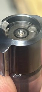

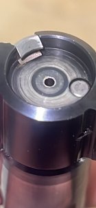

**UPDATE** looks like LRI is going to have two bolts from me to bush and thank you to the people that recommended them to me!!
These are brand new custom actions I payed good money for… first bolt only has 1,022rds on it (ran about 2950 majority of those rds). 2nd bolt has 505rds on it (ran mainly at 2900-2910). Was told by the manufacturer (who I do not want to publicly name) it’s from running the 7-6.5prcw over 2900fps with n555. Do your research before buying. Talk to the manufacturers before you buy about what you plan on doing and how fast you plan on running it and if they can stand behind their product confidently for you to do so.
I am looking for an experienced gunsmith to bush a bolt for me. I was told this steel on these bolts is very hard and don’t know if it can be done or not. Looking to get it sent to the gunsmith around 12/9/24 and hopefully have it back as quick as possible. As you can see in the pictures the firing pin hole tapers in, causing puckered primers. Thanks in advance
Sorry you’re having issues with your bolt.
I have heard rumors that some guys are having similar problems with their bolts - don’t know all the details - but apparently a few are popping up. Let us know how things work out.
