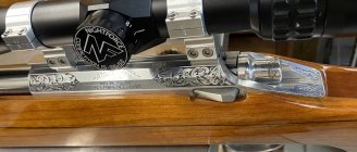

Pic of the used action as received. I may wait to start polishing until after I bed it so I don't scuff a fresh surface.
You can see the scuffs and signs of being used. Nothing major, should be easy enough to work out.

Here is the initial finished product. I'll go over it once more after it gets barreled and bedded.
I'm happy with it, of course I could have gone way further down the polishing path, but didn't want to have 20 hours into it. I need to work on the stock still and don't want to worry about a scuff needing hours of repair.
