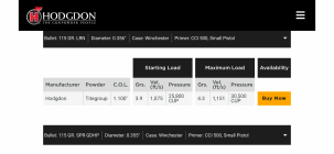

Tried unique 5.5 grains accurate #5 6.2 grains and titegroup 4.2 I like titegroup but it felt weak, anybody tried more grains with titegroup ,need suggestions

4.5 TG loaded to 1.125 is a solid choice.

Thanks I should be out shooting tomorrow if the rain holds, I'll try the 4.2 titegroup then move up ever so slow maybe .5 till I'm comfortable getting the best feeling and a good fps might get to 4.5 I'll put the specs on the site,I also made 10 bullets of unique and accurate #5 see what feels right.
