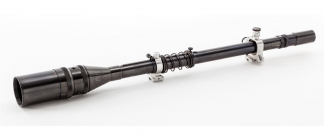

I believe this is a Unertl programmer. It is 20x, 26.5 inches long and has a 2 inch objective. Do I have the model correct and what would the value be? It is not in perfect condition but the lenses look clear without any scratches.

It's a 2" Target model. The Programmer had a fast acting cam that allowed you to focus from one popular distance to another quickly with far less movement required than any of the other Unertl models. It's not unusual to find the 2" Target described as a Programmer -- most likely wishful thinking because they were originally more expensive and fewer were sold. Therefore making them more desirable for the owner/seller these days.
