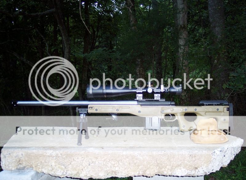

pic of rifle,,sometimes I switch scope off and shoot the PNW sight set,,
