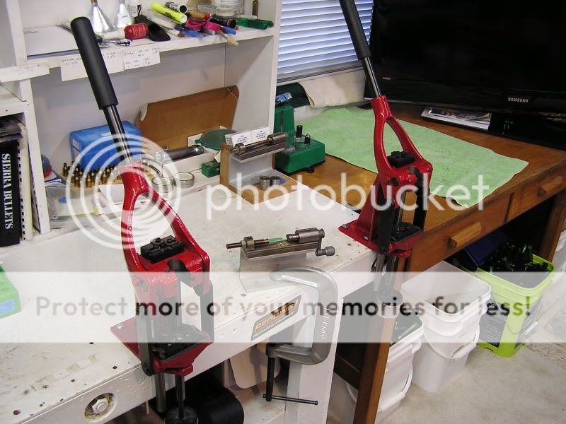

I agree with Bozo. As a matter of fact, the only drawback is changing between the large and small shellholders. However, there is a simple solution.

Jim,
I like it ;) Nice setup, same concept as I use with hand priming tools, find one you like, then buy a dozen of them so you have one dedicated to every type of primer you use. I am calling Forster as we speak to clone my bench after yours :D
