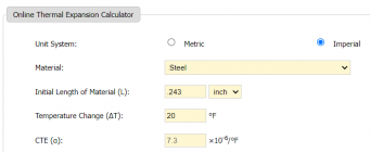

Some people think that a neck turning mandrel expands from heat and causes it to get too tight.
Below caliculation: A piece of steel .243" long heated 20F warmer. It expands 0.000013" longer or greater in diameteer. If the fit is tighter it must have to do with the case?

I believe Brass has a higher thermal expansion that most, perhaps all, steels. If heat was the issue, would not the neck fit on mandrel get looser not tighter?
I think Boyd nailed it when he said brass neck "spring back" was the culprit.
