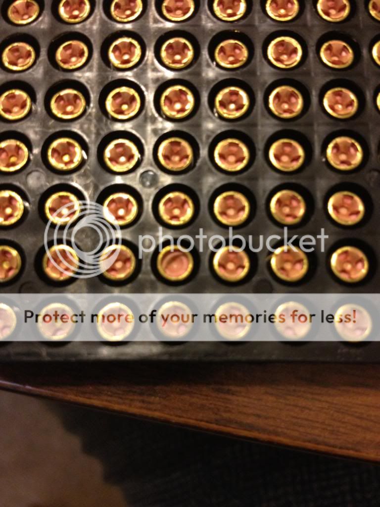

I've got some of the Wolf SRM primers......I've looked and there is no number on the box or the primer sleeves except for a lot number which looks more like a date than a lot number. The cups are brass colored.
Is there any way I can tell which ones I have?
I think the brass-colored cups is the best clue that those are either KVB223M or KVB556M, good for our purposes.
