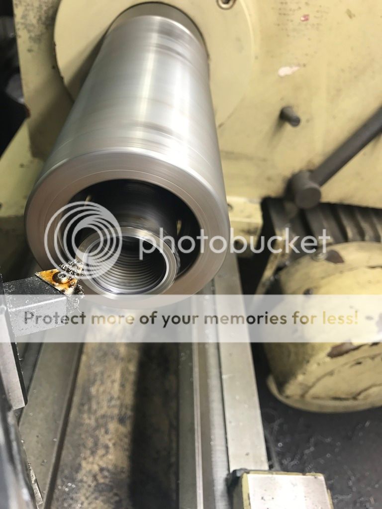

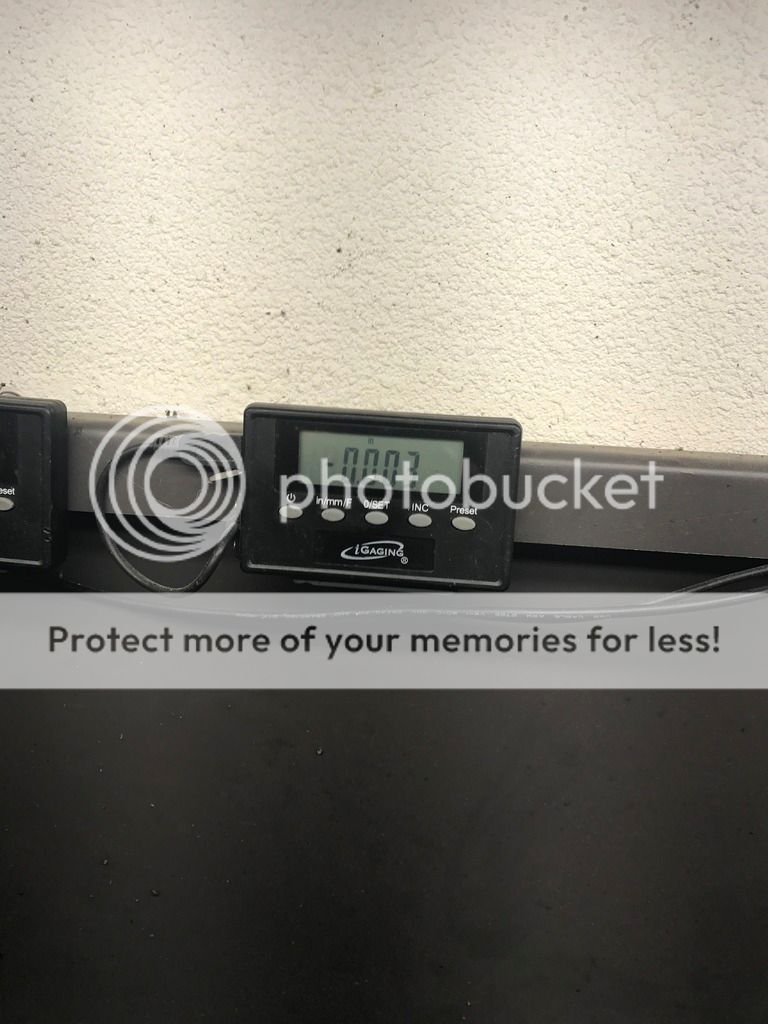

you would have to pull the barrel to check the action face if it was trued. heres some pics of an action I trued this morning.
dialing in the action on the bolt race way
First .001" cut
Took a total of .003" to completely clean up the face.

To 300-- What is holding that cathead in the lathe. It doesnt look like a chuck to me. Also I have wondered about these catheads sticking out pretty far and how guys get them to run true like that. I know thick wall tubing is used and that prob helps.
If the lettering is under the stock line the barrel has been removed and setback. They may have only used a different thickness recoil lug to do it, but thats not likely. Or it could be a barrel from a different gun. The date codes could have been cut off if the barrel was shortened but I dont know if remington made barrels longer than 26.
Hoz my lathe has a threaded spindle 2-1/4 x 8tpi, I threaded the inside of the tubing then trued the OD of the tubing to the spindle. The back of a LA rem is actually inside the spindle bore about an 1" or so. It does stick out a little, But I'm usually only run about 180RPM to face the action off with HSS.
I could run it in a steady rest but it doesn't vibrate or anything on me and I'm not seeing any deflection while dialing in the action or cutting. This might be due to using the heavy DOM tubing vs others that use aluminum to make theirs.
Hi 300 Thanks for the info. I just wasnt thinking again. Ive seen plenty of threaded spindle lathes but mine are D type. That cathead looks like 2 different materials? Im thinking of turning a mandrel for each action and just using it between centers with a dog to face the action but I would like to face the lug abutments to in the same setup so Ill have to work on that. I only do my own work also. Happy Holidays
Hoz, Its not two materials its a piece of 3 OD x .500 wall x 2.00 ID DOM tubing. The out side of the tubing was not concentric with the ID when I threaded it for my spindle and it was causing vibration at high RPM. So I turned it true to the spindle, I couldn't turn all of it off because my carriage was getting very close to the headstock and lead screw coupling, I use a pipe wrench to tighten it down on the spindle threads.
Ok that makes sense. I guess I will try making one of these with a slot in the side so I can use it on bolts. Thanks
