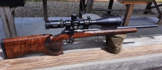

I've enjoyed shooting my CZ457s very much over the past several years. Was initially very impressed with the features of the then new 457 action - the fully adjustable trigger, side bolt stop, and most of all, how smooth & absolutely reliable the feed/function was. I also liked the proportions of the American stock, plus some nice attractive grain of the Turkish walnut.
But mine didn't shoot worth a hoot to begin with, and didn't get any better, even after I'd put 500+ rounds of mostly SK Std+ through it. I tried all the different lots & grades of SK, Lapua, & Eley that I had on hand, most of it stuff that shot really well out of a couple of jelrod converted CMP 40X actions that I'd put Benchmark, Lilja, & Krieger barrels with EPS chambers on. I did inspect the American's factory bbl with a Hawkeye borescope, and other than a fugly muzzle crown - which I re-cut in the lathe with a precision 11* crown - I didn't see anything obvious that could explain the poor accuracy.
Eventually, I pulled it & put it aside, replacing it with a Shilen select match ratchet in their #5 profile. I parted off the 1.20" shank and turned the transition radius down to tenon dia & length, chambered it with the same EPS reamer I've used on all my Vudoo repeaters, cut the extractor slots in an indexing fixture on my mill, and then finally CeraKoted the new bbl with a mixture of graphite black & tungsten in an effort to match the original bbl's nitride finish. It's now one of my favorite 22RF rifles, one that measures up quite nicely to a couple of very accurate Anschutz 54 sporters and a Browning reproduction 52C sporter with an absolutely lousy factory bbl that I had to replace with a Krieger that they contoured to match the factory bbl for me.

Shows a lot of promise, especially for cheaper ammo. Stick a tuner on that sucker and rock on.

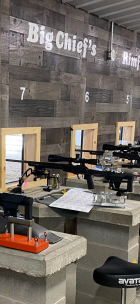

This is my 457 Pro Varmint with an MTR barrel. I removed the tuner so I could shoot it in an ABRA Outlaw lite class match yesterday. I was using SK PMS and came in second. The winner was shooting a Vudoo V22 sitting in a BR stock, using a one piece rest and Midas+ ammo. Conditions were cloudy, mid 50's and 10-15 MPH winds. My AGG score was 5.25 points less than his over four cards, 17 points total.
I was very pleased with my first match results.

what top is on the rest the bottom looks like a caldwell br
