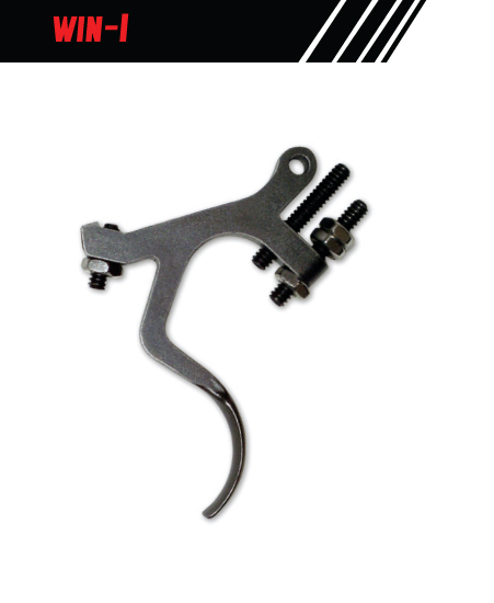

I just got a shilen comp that is 2 — 6oz
on recommendation from smith doing my project. There is no safety on that model. They do offer a 2nd model with a bit higher range and a safety.
They also have a standard steel model and a stainless.
Fingers crossed it works out.

Does Shilen make one for a Win 70?
