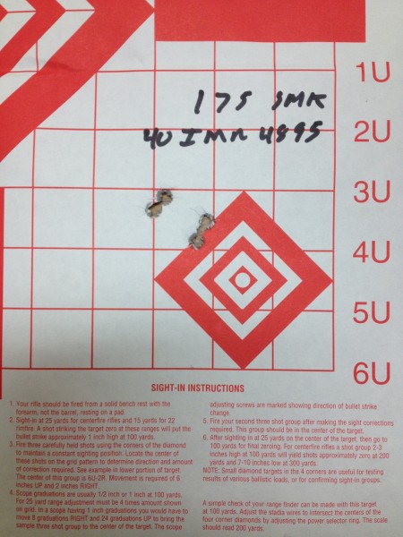

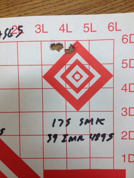

I jumped in here thinking I was going to see a real abnormal looking group like these . First two are 4 shots but that third one is a 10 shot group firing one shot after the other in 30sec-ish intervals .
Getting two distinct groups in the same string did have my head a spinning for a bit . This was several years ago and has been worked out but at the time I was at a lose until someone suggested I check the action screws . My rear screw was at 5# or 35# less then suggested . Tightened them up and I've not had a double group since .
