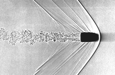

The bullet never goes through turbulence, because the turbulence is ALWAYS behind the bullet.
As the bullet slows down, the shock wave on the nose gets weaker and weaker, until it just disappears, so the bullet cannot pass through it.

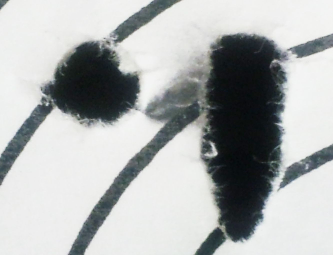

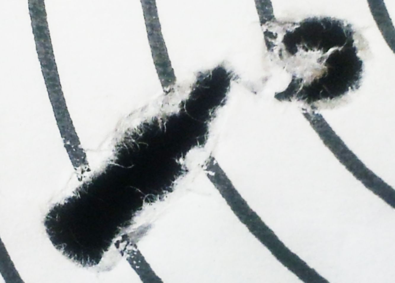

But, here is some photos of bullets that went sideways, from a twist the was perfect for the bullets, length, and speed... target was at 100 yards and bullet speed at the target was ~3,200 fps - not whacha call "trans sonic" ???
It is interesting to note that this last bullet hole looks shorter than the others, because it hit the target while in transition and was pointing at ~50° and had not gone fully 90° yet - which dispels another "theory" that bullets will fly in the direction that they are pointed like an airplane... which dispels another theory, that bullets fly in circular "screw" paths until they "go to sleep"... they are launched "asleep", or they go into destructive "procession" until they tumble.

Interesting keyhole pictures you have there, any details available such as caliber, bullet length and weight, barrel twist, muzzle velocity, etc.
.224"
0.665"
50gr
14"
3,500 fps
Target @ 100 yards.
