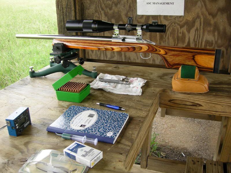

I'm kinda partial to the .204 Ruger. I built a custom 204 on a Panda action with a Shehane Tracker stock, Lilja barrel and Jewell trigger. I topped it off with a NightForce Benchrest 12-42X56 mm scope. I was amazed at the accuracy. You might be surprised as well.

Whats the reasoning for such high rings?

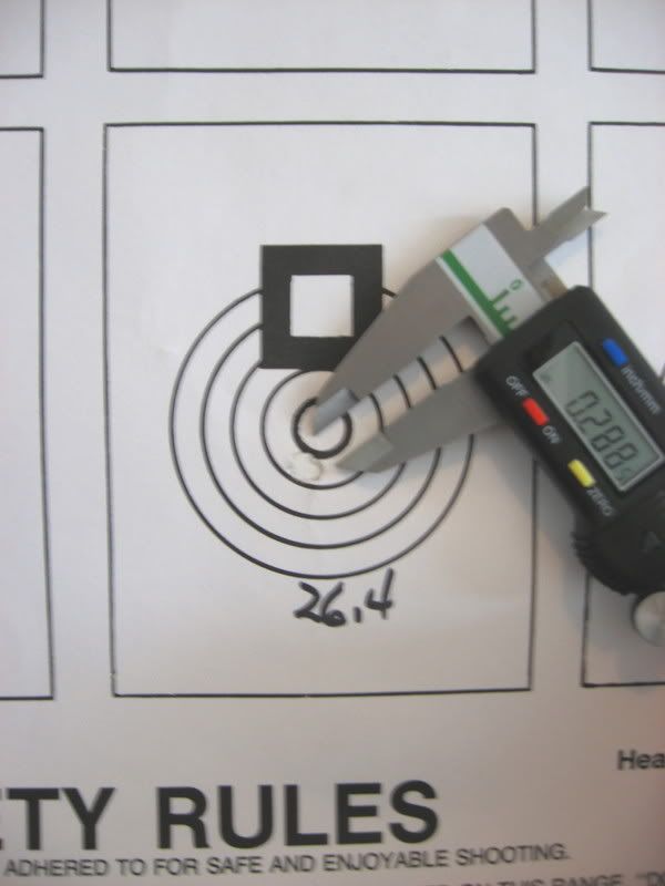

You can expect to post a nice group like that without someone like me asking what load your using! Care to share? Thanks.
Sorry, guys. The rifle was built by Stick of SG&Y rifles. It is a tight necked,.228) .204 Ruger. I finished the stock myself. It needs to be refinished by a professional, though. The rings are high but it doesn't seem to affect the groups as long as I keep the rifle level. The stock tracks like a dream.
The load is 35 gr. Bergers with 26.4 gr. of Benchmark, Norma cases turned to .011 and CCI BR-4 primers with the bullets jammed .015 into the lands. I use a .223 bushing for a little extra neck tension. It seems to work well for me.

skipper what length is that barrel on your rifle, I am doing a tac20 and trying to get some idea as to what length I am going to make the barrel, originally I was going 26 inch for most velocity but would love to go down to 20 inch as it will get used as a fox rifle in the winter and a walk around varmint in the summer, dont want to lose too much velocity though.
That is a 26" barrel. Speedy recommended that length and I agreed. When the man makes a recommendation, I listen. He also had me send the reamer back to PT&G to have the free bore reduced to zero. Good move.
