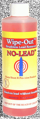

A few years ago I was given an old an old Sako .22 that had been under seawater for a few hours and afterwards wasn't discovered until it was a rusty mess. Apparently the bore was lead lined and it cleaned up well with Wipeout Leadout. Being shot a lot in its earlier life without much care was a gift in this case. Exterior was improved with a few overnight soakings with Kroil and then bronze wool light scrubbing.
The old gun is surprisingly accurate and well worth the effort.

I’ll probably get some mixed feedback on this but it will push literal streaks of lead out of a neglected bore.

That stuff perfectly cleaned a severely lead fouled pistol barrel. I’m not a fan of Remington Thunderbolts.. ….
I was given a really nice Marlin 1894 24” 357 recently. I have NEVER seen so much lead in a barrel. I tried ALL the methods listed here and then some…. (with a borescope) all any of them did is seem to “polish” the lead, it was still pretty much a continuous layer from the leade to almost the muzzle. Finally broke down and ordered this stuff. WOW. Took out half on the first application. A couple more applications did the rest. Not crazy about the flash rust it makes happen on the bare steel but it does soften/resolve the lead.
100% recommend.
