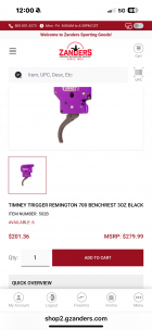

This is the trigger I’m speaking about at Zander’s
Wow, thats a nice price
From the pic (looking through the sear engagement window)
It looks like the top sear covers the internals
BTW this is the "Tactical" trigger I was speaking of
Very nice trigger and fits Rem 600/660 also which is kinda nice if you own one of those
Ill probably just buy one and see what its all about i dont like the trigger shoe from the picture hopefully its a bit different in real form
Nah, that's the way it is--at least the one I had. It was not bad to shoot, just have to forget about the look.
