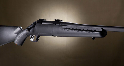

Afternoon gents,
Just curious if this is something anyone's had done?
Sharp Shooter Supply is known for working on Savage actions with good results, is anyone doing similar with Ruger's American?
Seems plenty of folks are doing barrel swaps with prefits, now thought this may be in the works too.
Thanks, Matt.

So finally got some feedback from a local smith re the T&T. He says it's the same procedure as any other receiver, they do a fair amount but not as many as the Savages and obviously nowhere near as many as the 700s.

There are severalmrifles out there with a similar design. Large diameter bolt with 3 lugs. Pretty simple to make with cnc equipment . Pretty accurate without a lot of hand fitting.
Yeah he said they were usually very close, may be part of why you don't hear about it being done much- the older rems and Savages prob weren't held to such tight tolerances.
I think you are right, they weren't CNC and some used to say that Remington's receiver face was so rough they thought they were saw cut.
