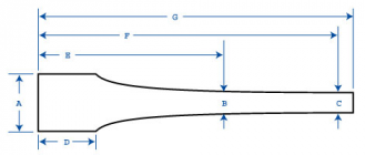

Just a quick question for you well versed fellas. I have a Tikka action that I would like to get a shilen barrel put on. Shilen's contour chart shows
3 Sporter (.358 and smaller)
1.220​
.815​
.625​
2.5​
6​
24​
26​
3 lbs 7oz.​

If I'm reading this correctly, any barrel contoured by Shilen will be 1.220" at the shoulder?
My tikka action is smaller than that. My measuring shows the outside width at the face of 1.200". The factory Barrel shoulder is 1.125".
So my main question is, with a Shilen contoured barrel, I'm going to need to have a smith turn down that shank a bit so it doesn't look strange? So if that is the case, I may be better off just getting an uncontoured barrel and having the smith do the whole thing?
Or have a gunsmith remove the short tapered section on the end of the receiver. That way you can use a larger shank diameter without it looking so weird.
Turning down the shank to your desired diameter is quick and simple work. Doing a complete contour, not so much.
Stick with the contoured blank. You'll pay more to have the smith contour it, and skinny sporter contours ain't the easiest to contour on a manual lathe and will not be of the same quality without ridiculous cost (time). Turning down the cylinder ("D" in the contour print) takes just a few minutes between centers.
Usually, when I do Tikkas I face the front of the receiver and solve the diameter problem making shank diameter a non-issue.
When you turn a shank down, its length of course becomes “longer”. I started with a blank having a short shank, so that when turning its diameter to 1.2”, it didn’t become excessively long. Just a visual preference of mine. As others mentioned, turning the radius off the action allows a 1.2” shank to mate up nicely.
