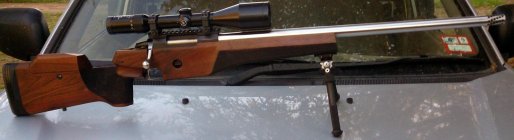

Hi,
After much looking around I managed to find a M595 with 2 bolts and I sent it to Skeetlee off the forum and he chambered a Kreiger LV 1 in 13.5 twist barrel for me for the lighter bullets and fitted a Harrell's brake.
It may not be original now but boy does it work. It is a super feeding varmint rifle that really shoots Lee sure does do some fantastic work .

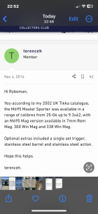

Boy oh boy, this brings back memories. Funny thing….I put that Master Sporter in storage and never shot it until last Friday. I finally decided I deserved it, what the hell!….and no, the 695 has a longer screw center. (That’s from my failing memory. I did one 695 in 338 Win Mag and I’m pretty sure it was a little longer but it’s been 6…7 years.)
Add: I like to confirm my sanity so I did a search and found this:
There were some master sporter tikka’s made in long action. Good luck finding one and better luck just finding a stock for the 695 in the master sporter. From Sako collectors:
Well …….that’s news! Thanks for that gem of info! I did not know that. Interesting!
I did a search and found this. It does make me wrong! I stand corrected!
