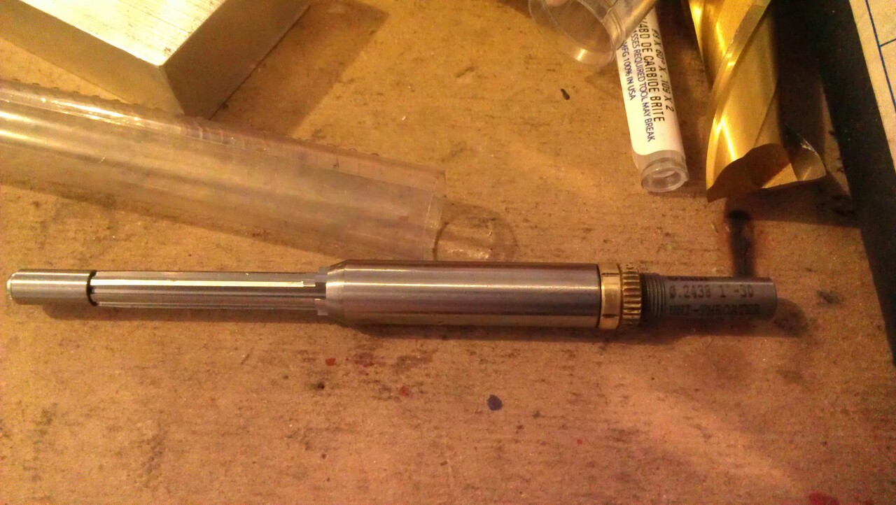

I simply want this reamer to lengthen the FB diameter of a 6mm Dasher. I have a new reamer, not PTG and the FB length is way short compared to my original PTG reamer. I want to lengthen the length in a separate operation to make it where I want it.

Mike, I got a PTG UNI throater with a freebore diameter of .2438".

Haven't used it yet, so can't answer that. I'm saying get one the same size as your freebore diameter or a couple tenths over and you should be good. The PTG is a pretty good deal and won't break the bank. What fb diameter is your reamer now?
The throat according to chamber reamer print is .3085'' with a tolerance of +.0004''.
With the same tolerance on the throating reamer it makes sense to add .0002'' to the throater and hope for a good match.
Be very careful using a throating reamer, you can't hardly feel them cutting.
Use a stop if you have one.
