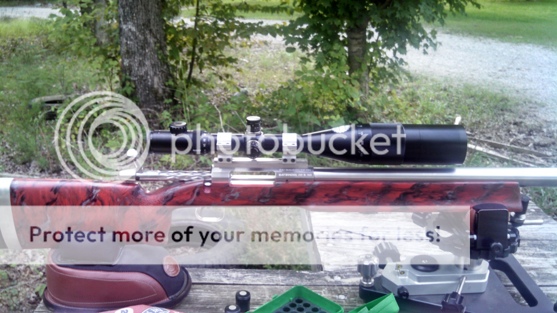

Gary the specs are
Bat dual port RBLPRE the barrel is a Lilja 1-10 x31" and contour is a 1.3" straight. Jewell trigger and a Mcmillan MBR stock. 20 MOA rail and a NF 12-42 BR model.
Brass used is Lapua and primers are F215m
Here's the rifle

That is an AWESOME looking rifle! The colors are GREAT! I also love the first "one hole" group! Excellent shooting!
