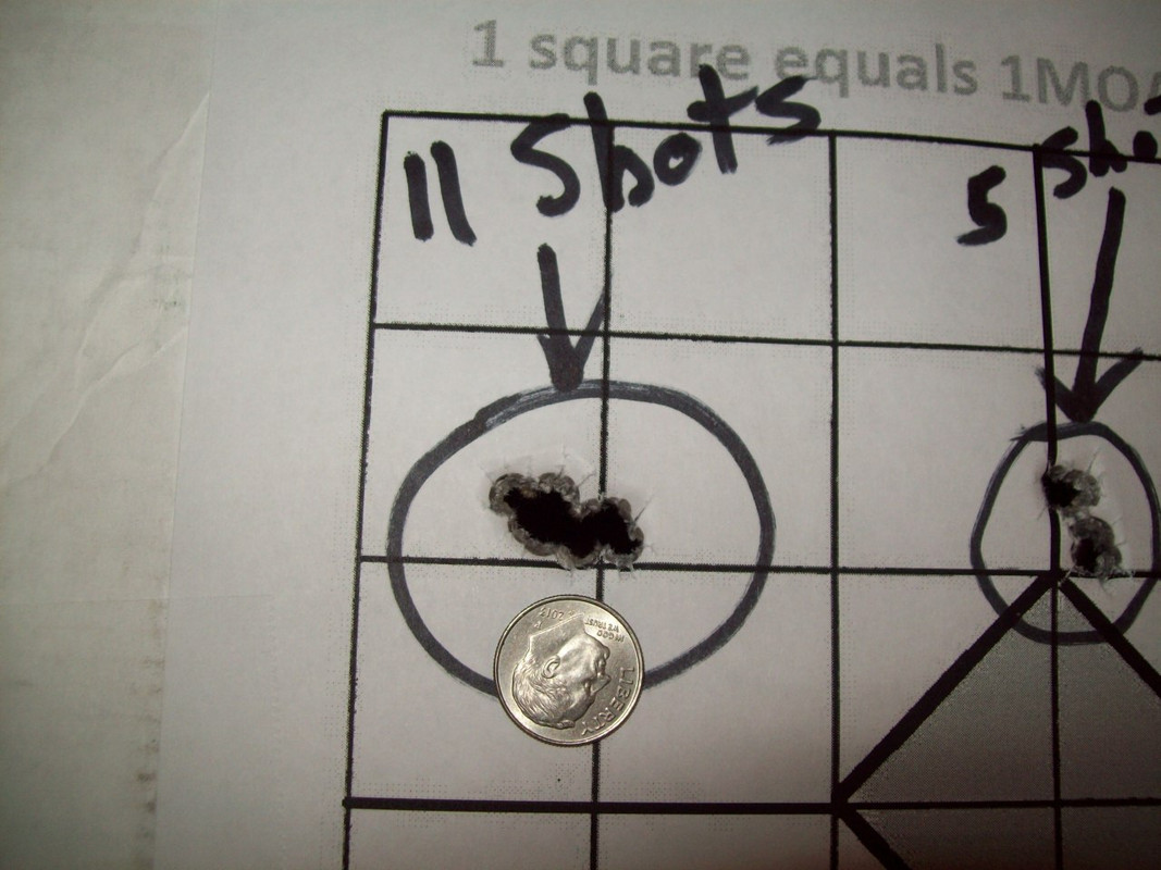

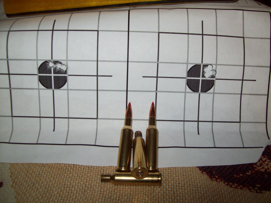

Shot the other half to fire form with the new Leupold VX 6 3-18x50mm. NOW the Old man can see. ***Picture at the bottom*** 11 Shots in one & 5 shots in the other.
Shot the Wasp today. :D
Pistol: Contender Easy Open Frame (10 Ounce Trigger BY Me)
Grips Georgia Jim Yellow Laminate
Barrel 16 Inch OTT Full Bull Matte Finish Chambered in 219 Donaldson (Long Version)
BullBerry Scope Base With Burris Signature Rings
Burris Predator Quest 4.5-14x42 1 Inch Scope
Ammo: New Winchester Brass Just Formed
IMR 3031 Powder (Old Thin Red Can) 24.2 Grains
CCI 200 Primers
Hornady 55 Grain V-Max
It was about 57 degrees wind calm. Distance about 60 yards. Sitting on Fuzz Rest. Solid even for an old man like me. This was a joy to shoot. Sad to say I have had it for three or four years and just got around to forming brass and shooting. Can't wait til I get some load development. The second box of new brass is loaded with IMR 4320. Can NOT WAIT See Pictures Below.
