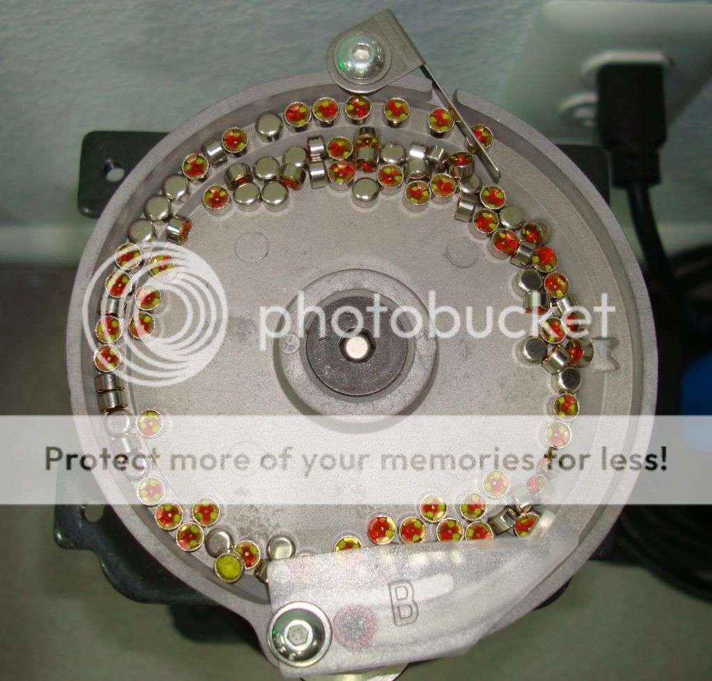

About 3-4 weeks ago I was loading some long range rifle ammo (6mm CM) in preparation to go to the Steel Safari in New Mexico.
I load on a tweaked Dillon 550 and Prometheus measure. I also use a Dillon primer filler cause it is faster than pick up tubes. I tend to load long range ammo in batches. This would be a batch of 500.
Around the 300 round mark I dump a tray of primers in there and hit the power button. I sometimes take a quick peek at the primers as they go around and get dropped in. Not because it looks cool when they go around and I like shiny things, but to make sure no primers get dropped in upside down. After a few seconds I see something that looked wrong and hit the stop button. Had I not been paying attention I would have missed it.
After 30+ years of reloading and too many rounds to even count, I see it. The mythical primer with no friggin anvil. I have heard about their existence from a few dudes over the years, but had never seen one. Much like Sasquatch or the Lock Ness Monster. I figured I has better document the existence of this rare animal.
The missing anvil was not in the plastic storage box or anywhere to be found, but you can see where it kinda was at one time.
A bad round would not have cost me the match, but it could have cost me a few places and a lot of concentration.
That's a first for me, never have seen that in person. It really is amazing that there are as few defective products as there are. We are fortunate. By the way, Good Catch!
Hoser,
Over the last 20+ years I've loaded and fired something on the order of four million rounds, and out of all of those, I've run into (I think) three (3) genuinely bad primers. Each was exactly the opposite of yours; anvils in place, but not a speck of priming compound in the cup. I've heard stories of primers produced in the fifties, and I guess it was a pretty common occurrence back then to have to check your primers for anvils before loading. Seems that QC has improved since then, but it IS a very rare situation. Given how stupidly simple primer construction is, and yet how tight the tolerances are for their going together properly, they really are little marvels of production.
Good eye on catching this one, too. They do indeed stick out like a sore thumb if one only looks at them, yet it's amazing to me how few actually DO inspect them during loading.
Got my 1st press in 1977 and have been at it ever since. I inspect components at least to some extent and have never encountered a bad primer. The one you caught is the first I've ever seen, good catch!
Thanks for posting, good to know they are out there!
I guess it depends upon the manufacturer, this has not been uncommon from this source for me, or this lot. About 3 - 5 per thousand. Annoying but keeps me on my toes.
