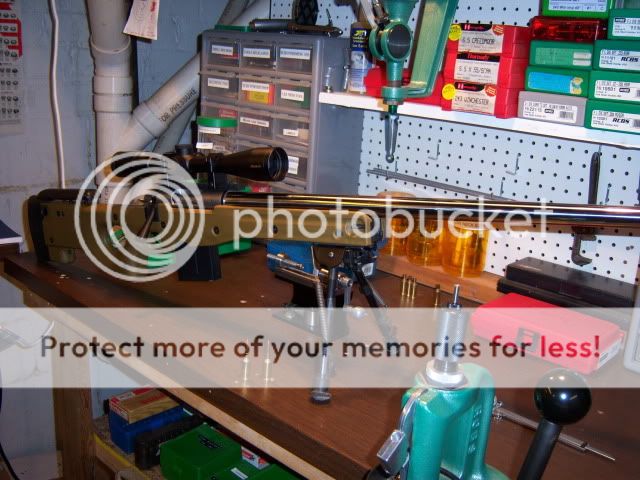

My Jon Beanland surgeon 22BR is finally home!! I was hoping to use a Mcmillan A5 stock that i bought for the project but the inlet wasn't exactly right so i had to switch out stocks. Here are some specs!!
Surgeon round action with pinned 20MOA scope base and pinned recoil lug. 308 bolt face short action.
Krieger 8 twist stainless LV barrel chambered for the 22BR using 75 and 80gr a-max bullets. 28'
Accuracy international chassis system with 10 round magazine.
TPS scope rings 1'
Nikon Monarch 6x18 scope.
Shilen trigger set around 1 pound.
Barrel work was done by Jon Beanland of Oklahoma. Jon is a very talented man and his work is flawless. The AICS stock had to have some inlet work so the surgeon bolt handle would lay properly. The machine work involved was time consuming and his work shows the excellency of his talent. This is my first custom action and every thing is real nice. Enjoy!! lee
Nice looking rifle! What is the intended purpose? My 22BR is very accurate with 80 gr SMK!

How does it shoot? The 22BR is sweet. Post some targets on how it shoots. You are keeping us in suspense.

Looks like you are in dire need of some of Pheonix Tactical's claw feet for the Harris. It will eleminate those stupid hopping rubber feet.
www.pheonixtactical.com
Great looking rig. I bet its a tackdriver.
