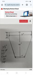

When I built my house 5 years ago, this was the first thing dropped on the property. A bench top from the St Louis range. $100 Dimensions attached. Rerods in concrete when floor was poured, and epoxy in bench top to rerods when laid. Sonotubes from floor to top encasing the rerods.20201216_151240.jpg
When I built my house 5 years ago, this was the first thing dropped on the property. A bench top from the St Louis range. $100 Dimensions attached. Rerods in concrete when floor was poured, and epoxy in bench top to rerods when laid. Sonotubes from floor to top encasing the rerods.View attachment 1614662
If you shoot from that window you'll shoot a dumpster and your neighbors house.
33” floor to top of top? Looks like a very nice setup— it doesnt look like a clear shooting lane outside the window. I must be looking at it wrong?
33 is correct. I believe that is the same as St Louis. I've got a concrete bunker with 1/2" angled plates in it on my target stand at 100 yards. It's left of the house...then there's the dumpster....yes, the pic is deceiving.
