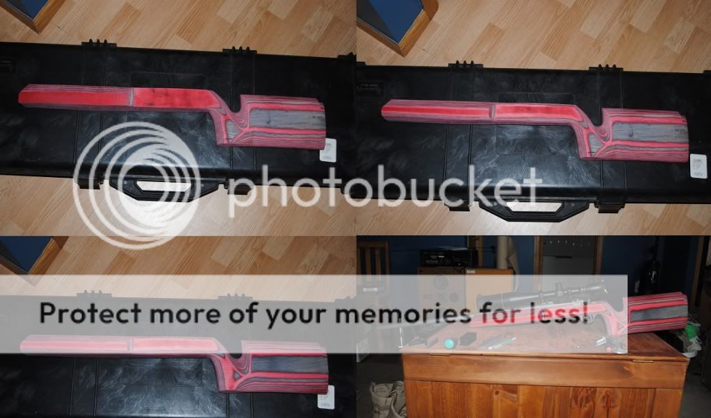

I debated posting this yet because the stock's not totally finished as it doesn't have the clear coat yet, but I figured why not.
I have some wood working experience and was curious if I could make a rifle stock. I found stock blanks on http://www.boydsgunstocks.com/ I picked out a color and I think it was around $40. I didn't have a clue how or where to start. Between using a lot of different tools and a decent amount of time I came up with this. It's still only finished in Tung oil right now, I plan on putting an automotive clear coat on it eventually if that's possible over Tung oil.
Inletting was by far the part that tested my patience the most, I didn't really end up with any good pictures of that process though.

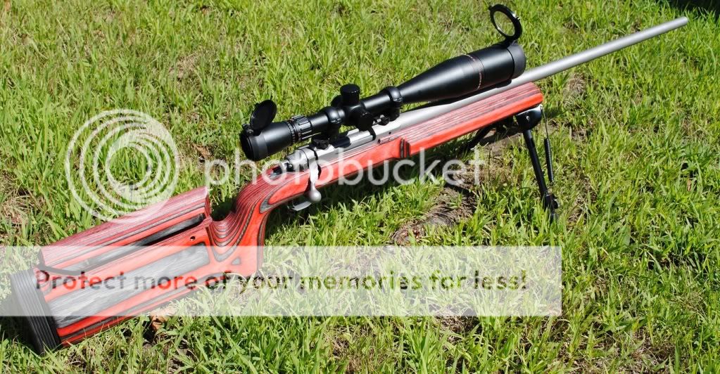

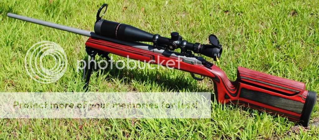

Rifle was/is a Ruger M77 VT 6.5 Creedmoor. The action was bedded with Devcon. Finished weight ended up being 15 lbs, I'm contemplating ordering a Broughton or Krieger for it now.
Making the cheek an adjustable was quite easy, I even made the hardware myself.
On with the picture sequence.

Nice job on the stock, looks excellent.
I have a bit of painting experience, as I worked in my step-fathers body shop as a teen. I am not 100% sure, but I think you will have issues trying to clear over Tung oil. But if you sand it very fine, and rub in a whole bunch of coats of Tung oil, it will have a great sheen anyway, and be easily touched up by just rubbing in more Tung oil.
My buddy is a wood worker, and he loves Tung oil. Some of his stuff looks like glass and only has a Tung oil finish. I would just use that and make it shine.
But agian, very nice work. Looks awesome, especially for your first time. Looks like you have been making stocks for years. I doubt anyone would have known you made it if you didn't say you did. Really looks great.
Kenny

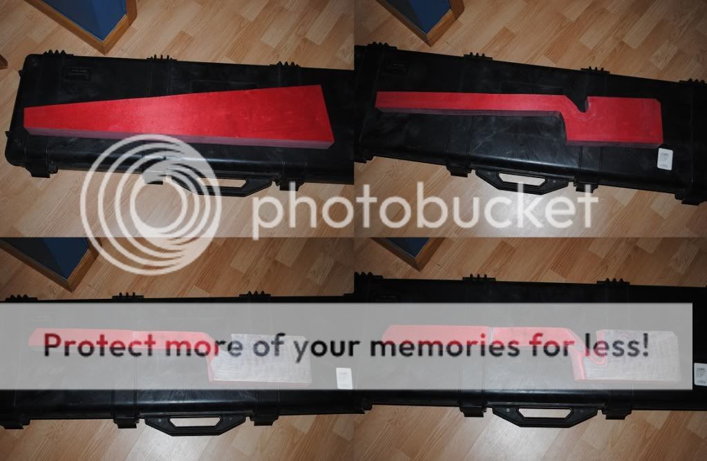

The barrel channel was pretty easy, just used a router with an end mill, kept going deeper and deeper. I left the last 1/2 alone and carved that out to a radius by hand so it looked right.
I used a router on this project a lot to take away the excess material, you can see in the first few pictures that I just took off a certain depth on each side up to certain matching points.
The fore end was just that wide from the blank, luckily I didn't have to add any material there.
I worked on this thing a lot for about a week and a half. The tools I used were a Porter Cable router, various router bits, 3 different sizes and shapes of rasp files for wood working, a high-speed disc sander, coping saw, electric finish sander and of course, a Dremel tool and a multitude of attachments.
The laminate is for sure easier than a hardwood I'd say because as you remove material you get into different color layers so you can make each side symmetrical. I won't lie though, inletting was the hardest part, but Devcon bedding makes it so it doesn't have to be perfect, there's some relief there.
