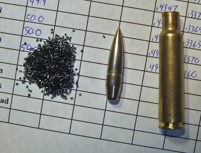

I had a great load with the 240 gr SMK (no longer made) and RL-33 in one of my 300winmags that had a fairly short freebore, and I wanted it to fit reliably in a 3.5" magazine. So I loaded it to 3.450" COAL.
The 240 SMK has the longest bearing surface I've ever seen on a .30 cal bullet. It was seated really deep in the case. I still got great accuracy and velocity. Everything from 75 gr and 77 gr of RL-33 had the same Point of Impact. Thus I went with 76 gr @ 2,770'ish fps from a 26" barrel.
220 yards 4 shot group...
Didn't need to burn up the barrel any more. Load development took 20 bullets ( 4 shot groups @ 75 gr. 75.5 gr. 76 gr. 76.5 gr & 77 gr.) and saved a bunch of barrel life.
