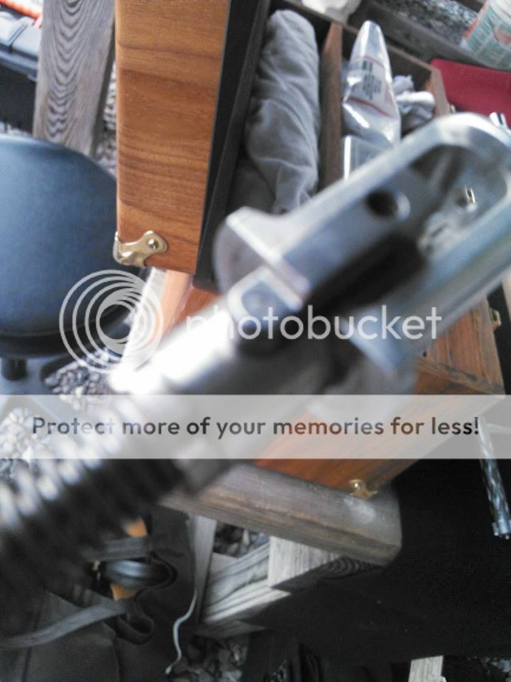

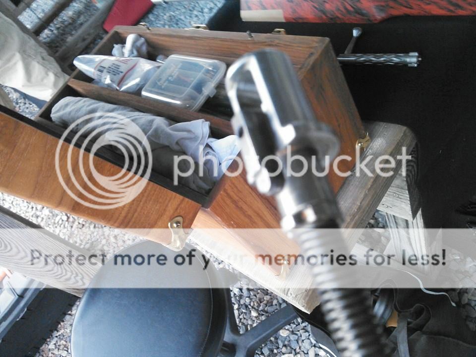

My phone seemed to focus on the aft.. The first picture you can kinda see how it is pinned and can imagine a roller that would ride on the cocking cam..Someone personal messaged me that they have this on another action so that pretty much answer my question.. Now can I just order the part or do I need to send it to Mr. Scott? Monday I'll call I guess..
