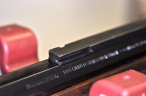

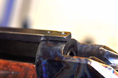

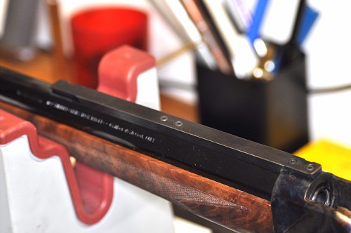

But upon looking at the rifle and the Malcolm rings, I figured I could whip a one piece mount up myself.
I grabbed a piece of stock out of the scrap bin and let my milling machine have its way with it.
Here's what we turned up with.....
And the finished product......
Tomorrow we'll give it a bit of a workout.........Range report to follow!
