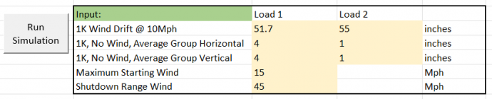

Instructions:
First, input your parameters in the box. You will need to have a theoretical group size (both vertical and horizontal) and the 10 mph full value wind drift for each load.
The Maximum Starting Wind is used to make average conditions more ferocious or mild. The system picks a random starting wind for each relay between zero and the input value.
The shutdown range wind is used as a cap for wind speed. For example, above 45mph at Rattlesnake, we start snapping frames off, and have to stop shooting.
With your input done, just click Run Simulation to get the program started.
NOTE: if it doesn't work, look for the amber bar above the sheet. Content must be enabled to allow it to work:

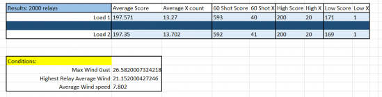

Output:
The system outputs the average score and X count for 2000, 20 shot relays (the approximate equivalent of 20 years of shooting F-class) plus the maximum and minimum scores achieved during the 2000 relays. All of this is based on a few assumptions:
1) The wind changes, at least slightly, from shot to shot
2) The shooter does a reasonably good job of guessing what the change was, but has a normally distributed error in that guess (mimics my performance). The shooter also never accounts for the vertical component caused by headwind or tailwinds after the first shot.
3) Bullets fall within the group in a normally-distributed manner.
4) The shooter's wind call, in discrete mph value, is used to calculate accurately the proper wind hold for each individual load.
The output also tells you some environmental conditions during the 2000 relays:
1) Max wind gust
2) Highest average wind for one relay
3) Average wind speed for all shots/relays
I have 2 sheets, as I've found a distinct difference between mid and long range.
What does the A2A mean? It means Apples to Apples. How do you like them apples?

Hmm.. I get this error after enabling macros.
Any ideas?
I haven't actually played with this (I don't have excel), but that error usually means something along the lines of inputting text when it expects a number. To a computer, the text '5' is different than the number 5, for example.
This is excellent, Keith. I'll throw in a slightly different approach to this - a free simulator I wrote and put on my website.
You can enter various ballistic factors and the variation in those factors to simulate groups.
Check these fields and make sure they have only numbers in them. The Call Wind tab, and Simulation tab
I did that. Meaning I made sure the format was number.
What is odd is the wind call tab has no numerical values - unlike like yours does
