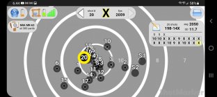

Tested it at 24.0 grains and Berger 80.5's with my service rifle (20" barrel, 4.5x scope) slung up at 300 yards on the NRA MR-63 target. Very happy with the results. Had 4 shots left that I chronographed with my magnetospeed at 2687 fps avg, 18 SD.
