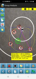

I was doing a load work up for a 600 yd load for xtc matches comparing the RMR 75's to SMK 77's. The load is 23.5 H4895, c.o.a.l. 2.38" (single load, obviously).
The rifle is an off the shelf Windham, 20" govt A4 model with a 1:7 chrome lined A2 profile barrel, floated A2 handguard and Schmid 2-stage trigger. All testing was done at 100 yards in a zero wind indoor environment.
The RMR's are the left target, the SMK's the right target.
To my surprise, the overall group size was the same. The SMK's had a slightly smaller mean radius, but only because 2 rounds were touching. I'll let the pictures speak for themselves. I'm happy with the RMR results.
