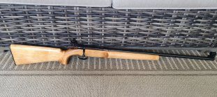

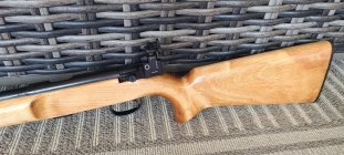

I just bought one a couple of months ago. Very accurate rifle, but the trigger was horrible (8-1/2 lbs on my Lyman gauge) and non adjustable. I found an adjustable version that would fit and put it in the gun and using a shorter spring I was able to get it to a crisp 1-1/2 lbs. I also refinished the stock and added a taller set of Williams sights. As it sits today. I have shot several one hole groups with it so far.

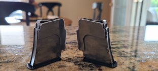

The magazines are plastic but I found a source for metal mags. Expensive but well made and they work great.
