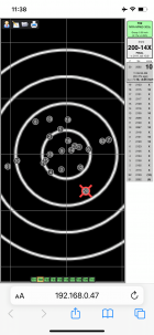

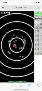

Back a few years ago when I was shooting some at a 300 yards reduced course sling prone slow fire AR XTC these were SMK77 match results. Shot better than I could hold.
