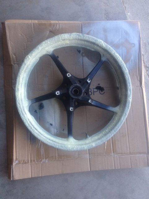

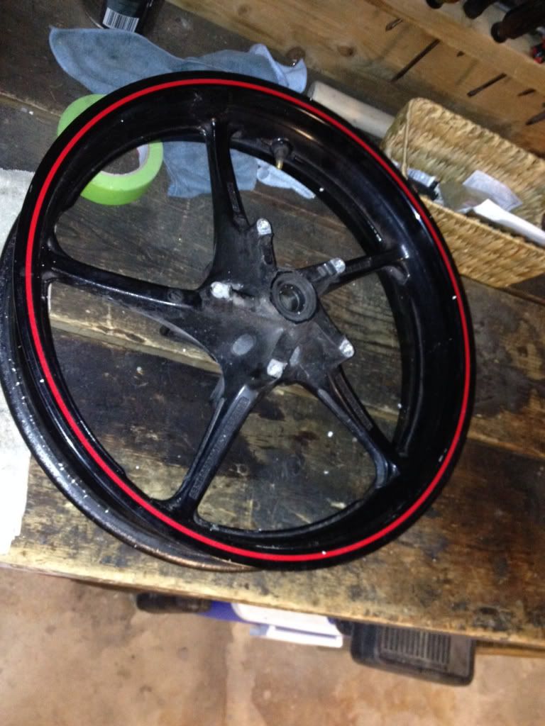

Go to an auto parts store and get a can of aircraft paint stripper big black can. It'll do the job. I stopped dura oat off my rifke and it'll take powder coating off too. About 12 bucks. Follow the directions and it'll come off in about 5 mins
This is the wheel I did on my motorcycle
Spray it on thick. Let sit for a few minutes
Hit it with the spray nozzle on the hose
I did it twice to remove all the paint off the aluminum
This is how it started
