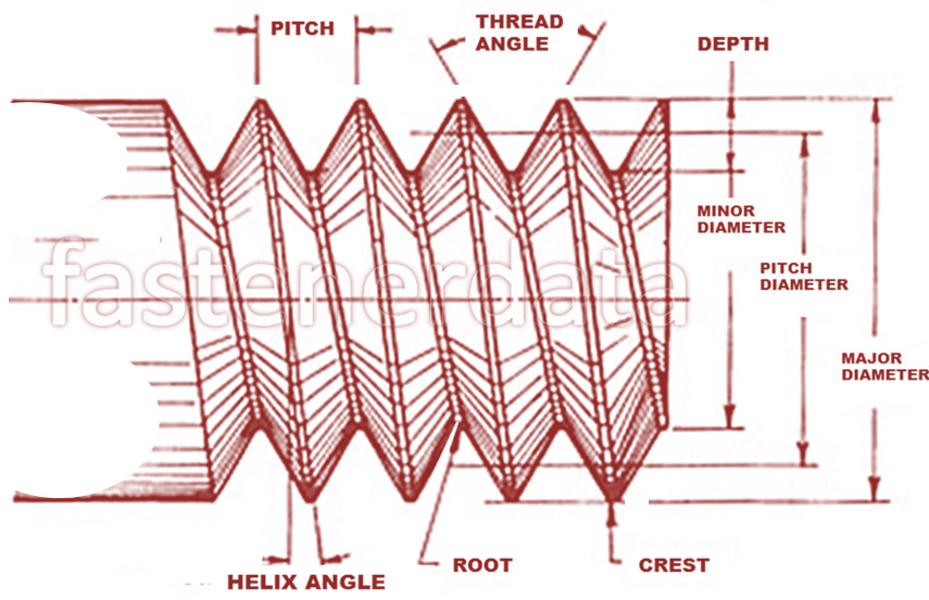

What is " 1.5X the root of thread engagement" expressed in?
expressed in a ratio.
Threads have a major and minor diameter.
axial engagement = 1.5 times the root = 1.5 times the minor diameter
1.5 = engagement in inches / minor diameter in inch
The inches unit cancels.
