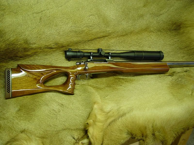

I did a lot of research on thumbhole stocks before designing mine. One of the things I found out about many of the designs on the market, is that they are just a sporter stock with an angled hole for the thumb. There seemed to be very little thought involved with ergonomics. Placing a hole in a sporter stock for the thumb, pulls the index finger away from the trigger. If you have extremely long fingers, it might work out, but for most shooters you have to stretch to reach the trigger.
Of course the solution is to redesign that portion of the stock and consider moving the inletting back so the trigger can be reached comfortably. My thumbhole stocks have a large area that is cut out that allows the thumb and palm area under the thumb to wrap around the stock. You could also consider them pistol grip stocks. Regardless, they allow a normal person to reach the trigger comfortably.
So…..if you decide to build a stock whose thumbhole compliments the position of the trigger hand, then you must have a pretty good idea of the location of the trigger shoe. That would decide when and where I roughed in the hole.
I use auger type bits to remove the bulk of the material, drilling side by side holes. One time I thought I could save a few minutes and use spade type bits that are faster, the idea cost me a nice heavy duty drill and some almost broke fingers.
