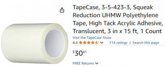

You get a roll for less than 20 bucks and it'll last years. Even for me I get a year or more out of a roll. And you can buy whatever width you want, they come in a lot of sizes.
Measure the distance you need to cover (foreend or butt) and buy the width accordingly, they have a lot of choices.
https://amzn.to/40OZ2Lk
Will the tape in the link listed, be able to be removed without damaging surface?
As others have said, I'd suggest "sticking" with a known product due to adhesives used. I've seen some that was absolutely brutal to take off, where damaging the stock isn't just possible, but likely.
My favorite is still the ugly brown teflon tape with a silicone adhesive. It can be removed and is most functional, IMO. But yes, it's kinda ugly. Pretty is, as pretty does, though. It can be really slick if you rub in some teflon powder or carnuba. The texture actually helps hold the powder rubbed into the fabric, I believe.

I have a 3" wide roll of that tape off {Amazon I think} that goes on all my rifles fore end and butt stock that along with a sprinkle of baby powder on the rests definitely improves the "slideability" of the rifle during recoil...
It also removes without leaving any adhesive residue or paint damage.
It was replacement tape for a thermal sealing unit...
Yep! Not as pretty as the clear stuff but it works just fine and a 15' roll will last most folks a lifetime.
* Another source to check with is the bicycle world where they sell clear vinyl pieces to protect the paint from "chain slap" and stone chipping...
Also found some clear in a roll at the local automotive paint shop that is used to protect the paint on the top rails of a pickup bed when mounting a camper shell.
This stuff was absolutely clear and not the "Translucent" that I see on the the posted links.
