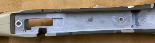

I couldn't find a stock without substantial wait times so I bought a basic from Bruno's and inletted and bedded it myself. Turned out pretty good for a first-time inlet and first0time on a mill. It shoots awesome, which is what I was after. Id say go for it. I took my time and didn't have any issues. Just a lot of double checking before I started cutting.McMillan Inlet.jpg
I couldn't find a stock without substantial wait times so I bought a basic from Bruno's and inletted and bedded it myself. Turned out pretty good for a first-time inlet and first0time on a mill. It shoots awesome, which is what I was after. Id say go for it. I took my time and didn't have any issues. Just a lot of double checking before I started cutting.View attachment 1356413
Nice job. Inletting is the next thing I need to get comfortable with. You're braver than me!
I shoot an X-ring for F Class, but wanted one for ELR with an ARCA rail on it. I got the basic inletted stock for around $500, so I figured it was worth the chance to try and learn. It was not difficult at all really. Believe me, if I can do it, you can do it.

That’s very nice. You shouldn’t have said how easy it was, because now I’ve got to ask, - how much? I have a couple basic inlets and a flattop.

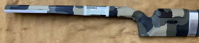

Just take your time and think about every cut before you make it. It’s satisfying to cut the blank and finish it to completion. It’s a slow process!!!!!!

Making the wood bolt knob and bolt shroud is a subject for another time. Lmao I don’t think I’ll be doing many more!!!!!!
